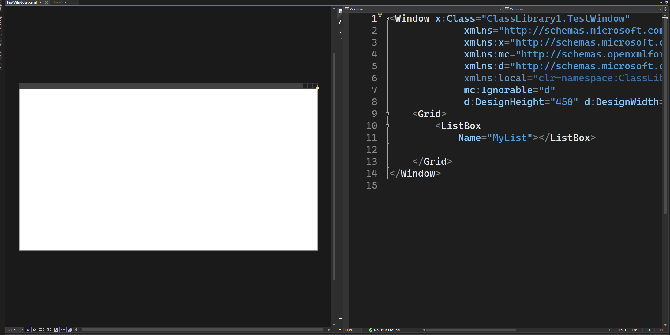

A_S_E_
Hello Arshad,
Thanks for reaching out, here it is
