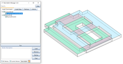

You can try this code (GitHub CustomCSG) . It finds the intersection of two PlanarFace lying in the same plane and returns a List<PlanarFace>
PlanarFace planarOne = null; // select your first PlanarFace
PlanarFace planarTwo = null; // select your second PlanarFace
List<PlanarFace> booleanPlanarFaces = planarOne.ExecuteBooleanOperation(planarTwo, BooleanOperationsType.Intersect);
Result of running CustomCSG.dll.CommandCaller by AddinManager in sample project ProjectToView.rvt
