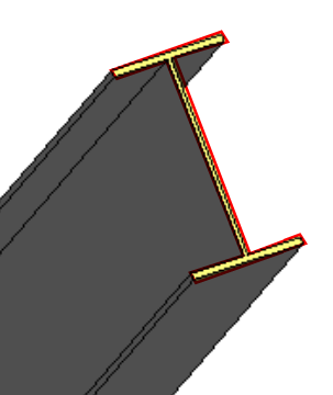

I've tried to get this method to work, and it does find the "top" face, but fails on steeper beams.
Here is the face I'm looking for:
On beams steeper than ~28 degrees, this is the face it gives me:
Message 7 of 15

I'm thinking that I need to find a new way to analyze the geometry, but I'm not sure where to go from here.

Revitalizer
you could compare also
  • the number of vertices of the faces (front face: 12, top face: 4)
  • the location curve's direction with faces' normals and negative normals (to exclude front faces)
  • the area of the faces (fron face is smaller than top face)
Revitalizer

Message 12 of 15
jeremytammik
There are indeed easier and more foolproof solutions.
You can just grab all the faces' normal vectors and choose the face whose normal face is 'most vertical', i.e., has the smallest angle between it and the Z axis.
If you are not interested in the end faces of the beam and wish the end face to be ignored even if the beam is very steep, then you can add a check for the surface area of the face, .e.g. to eliminate the two end faces, which will presumably have the smallest area. You can also easily eliminate the end faces by rejecting any face whose normal vector is parallel to the beam location line.
I hope this is clear and provides you with enough to achieve a really satisfactory solution for all cases.
