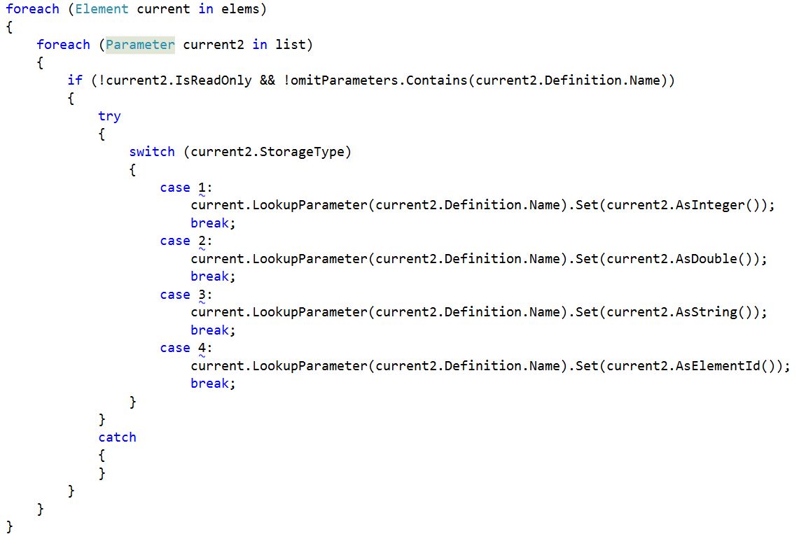

Hi again!
I'm trying to make a switch per StorageType parameters on elements, but in each case I have mistake " Cannot Implicitly convert ty int into Autodesk.Revit.DB.StorageType".
This is my code:
Anyone hnow what's going on?, Any idea?.
Regards!!!

Hi Carlos,
First of all, when ever you post code in a question, try doing it with the text not a picture of it.
Second I really don't understand what are you trying to do in your Switch case. Could you explain a bit more on it.
Here is an example of a Switch case using StorageType
private string ParameterValueForType(FamilyType type, FamilyParameter p)
    // return a string with the value of the parameter for this type
    string paramValue = "";
    switch (p.StorageType)
        case StorageType.Double:
            paramValue = type.AsDouble(p).ToString();
            break;
        case StorageType.ElementId:
            paramValue = type.AsElementId(p).IntegerValue.ToString();
            break;
        case StorageType.Integer:
            paramValue = type.AsInteger(p).ToString();
            break;
        case StorageType.String:
            paramValue = type.AsString(p);
            break;
    if (paramValue == null)
        paramValue = "";
    return paramValue;
Maybe will give you and Idea on how to solve your problem.
