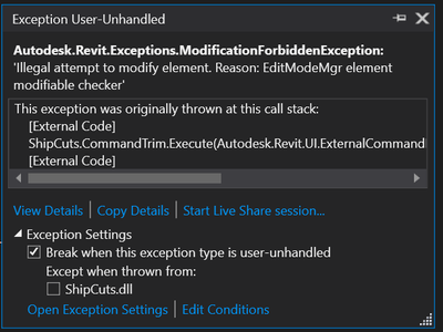

if (sketchEditScope.IsPermitted)
sketchEditScope.Start(f.SketchId);
This code did work previously. There is no transactions going on.
The error message is very hard to really understand.
Does anyone have any suggestions?

The solution was to move the floor and then back 🙂

You should probably create a minimum reproducible case for that since that exception isn't listed in RevitAPI.chm for the API call you are making. So to me it is either something they haven't explained or something they haven't anticipated you ending up handling.
