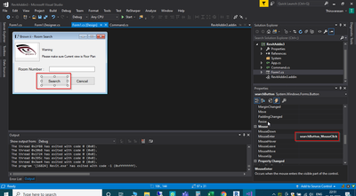

@RPTHOMAS108  thanks, I'm in the learning stage on C#  now, So I also asked the question in StackOverflow but yet not get an answer. then change the MouseClick event instead of the Click event but still the same problem.
this.searchButton.MouseClick += new System.Windows.Forms.MouseEventHandler(this.searchButton_Click);
Message 4 of 17
T52K-BIB
@RPTHOMAS108 I check button Properties and i assign MouseEnter value now it's working.

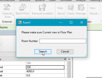

my IExternalCommand will implement below image
@RPTHOMAS108  From the Floor / Ceiling Plan view to find a ROOM in a Large scale Project is too hard and only the option goes to schedule and highlight. so that I make this add-in for my own purpose.
