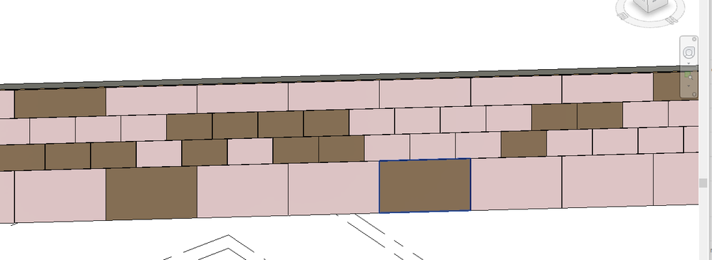

I am trying to set different materials to different parts of a wall like shown in the picture below.
My current method allows me to set all the parts to have the same material, but doesn't let me assign each part its own material. Here is my current approach:
1) Get all the parts in the file (this is a controlled file where I know exactly what parts are there)
2) Check whether a part is currently set to material "Facade Material" -- this is how I've organized my wall ahead of time and I only want to change the material of parts of the wall that have material "Facade Material"
3) Set each part's built in parameter "Material by original" to false
4) Set each part's built-in material parameter to my desired one
The issue is, once I set the material parameter for a given part, then it changes the material parameters for all the other parts.  I'm not sure if the concept of instance parameter vs type parameter vs family parameter holds for Parts, but from the object browser in Revit, the material parameter seems to be an "instance" parameter.

I figured it out. It had to do with my transactions.
Once I wrapped the setting of the two parameters (pOrig and pMat) in their own transactions for each part, it now works properly. It looks like all other parameters get set to read only when you change 1 parameter for a part in a single transaction?

RPTHOMAS108
Yes that makes sense since second parameter would also be greyed out in UI if first is not set to false i.e. the ability to set second parameter is dependant on value of first.
This also highlights the importance of order when batch processing built-in parameter values. There are a few add-ins out there that populate parameter values but they probably are not considering such relationships between parameters.
jeremy_tammik
Congratulations on solving it and thank you Richard for the explanation.
In that case, you can very probably increase performance by using only one transaction after all and replacing the multiple mini-transactions by calls to doc.Regenerate.
