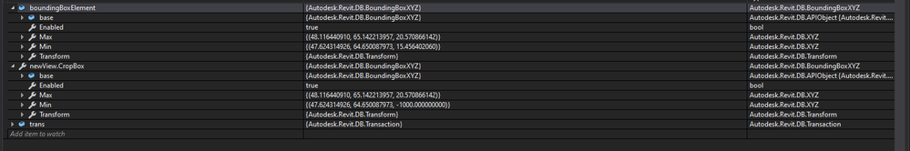

@TripleM-Dev.net  @bhprest  thanks for your answers. But I can not do it well yet.
First of all, my view is a ViewPlan.
I am trying to set a cropBox in the view to see just a element. That's why I get element.get_BoundingBox(null), then I set view.CropBox with element boundingBox value. As @bhprest said " min/max members of the input are used " I did the following
         newView.CropBox.Min = boundingBoxElement.Min;
         newView.CropBox.Max = boundingBoxElement.Max;
But when I see it in the debug, neither value has changed. However, if  I do
      newView.CropBox = boundingBoxElement;
CropBox changes.
my code now is:
  using (var trans = new Transaction(doc))
                trans.Start("Set cropview");
                newView.CropBoxActive = false;
                var boundingBoxElement = elem.get_BoundingBox(null);
                newView.CropBox = boundingBoxElement;#Part2
                newView.CropBoxActive = true;
                newView.CropBoxVisible = false;
               trans.Commit();
Just before starting #Part2
Both BoundaringBoxXYZ are different.
Once they have been assigned with
But after committing the transaction the view.CropBox changes and has the previous value again
I have checked the transaction and it was committed successfully
Any clue?
RPTHOMAS108
Might be it rejects the bounding box taken from the Element because some other aspect such as transform/BoundsEnabled etc. is invalid for the bounding box required by the view.
For a ViewPlan try getting bounding box from view and assign to independent variable then set the max/min based on bounding box from Element and then pass entire updated bounding box from variable back to view (rather than just it's properties as was done in first attempt). You may be bypassing hidden setter logic of the View.CropBox property by changing the properties of the bounding box directly (I've never found that to work).
Also set CropBox active before applying bounding box.
I've just found the error,
when there is a previous non-rectangular cropBox in the view. First you should remove the shape
                var shapeManager = newView.GetCropRegionShapeManager();
                shapeManager.RemoveCropRegionShape();
 And then you can set the boundingBox that by default is a rectangle.
