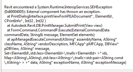

Hi, I am getting this error and Its completely thrown me for a loop.
I am printing sheets using the PrintManager and my program woulds fine on a smaller project printing 1 or 2 viewsheets... but for some reason when I run my program on a bigger project with more viewsets the program crashes my display.
SEHException stands for Structure Exception Handler Exception.
There has been a fiew posts on stackoverflow on this but overall they have been unhelpful.
The error is caused by the line printManager.SubmitPrint();
I guess it is a longshot and maybe this isnt the right place to be posting as i think its more of a .NET issue then a revit API issue. but if anyone has had a problem like this it would be very helpful to know how i should approach diagnosing what the problem is.

Managed to fix it, the test case was using was printing out an extra sheet i was not aware of, i dont know why it was causing the issue but it is fixed now.
Apologies for wasting your time.

The document i was printing from contained about 70 sheets and i thought i had the correct sheets in my set selected but there was one i left checked by accident. for some reason that particular sheet was throwing this exception when printing it. It was quite a large detailed sheet and i do not know why it was crashing my Display driver, sorry I can't help any more its probaby a problem caused by my computer, it needs replacing.
