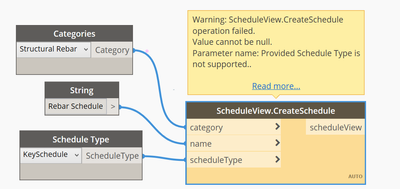

Schedule Type is not supported
2151110042
235 Views
2151110042
it's always said that even i choose any Schedule Type
236 Views

Looks like an error in one of the arguments. Please provide the relevant code snippet throwing this exception. If it is in Dynamo, you might be better of discussing in the Dynamo forum:
TripleM-Dev.net
In the API keyschedules are created differently then "normal" schedules.
The Dynamo might let you select "keyschedule" but it's a different kind.
See: CreateKeySchedule  and this is for creating a schedule based on a category CreateSchedule  and that ons is the one created by that node.
While you have a select node selecting any type the Create Node doesn't accept that type as the API method can't do that. Look if there's a node for creating a Keyschedule.
Also try the Dynamo forum.
