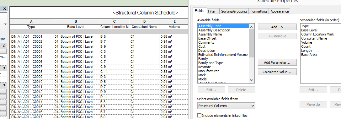

1- While creating a Beam Schedule I want to add a "Beam Location Mark" and Slab location mark in terms of grid Similar to Column Schedule.
I want to locate Beam in form of  B1-E1 0r B1-B5. Similarly for Slab Location Mark in form of B1-D5. Can anyone help me out?
2- I also want cross Sectional Dimensions (length x width) field in Beam and Column Schedule. Please Help me out.
