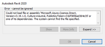

Hi Jeremy, I've had no issues with accessing a MongoDB from Revit. But now I'm trying to access a CosmosDB, and get the following error:
Any idea what may be the problem?

Your database connection may be requiring a specific version of a DLL, whereas some other component or Revit itself has already loaded another version, preventing the one you need from loading. Or some other variation of DLL hell. Quite a number of similar DLL loading problems have been discussed previously and often resolved in various ways here in the forum. Search here for 'load DLL' for example. One method (the most extreme) to disentangle the dependencies is to separate the process and use IPC to communicate:
https://thebuildingcoder.typepad.com/blog/2019/04/set-floor-level-and-use-ipc-for-disentanglement.ht...
People have recently discussed and used Fuslogvw to explore and resolve such issues:
https://thebuildingcoder.typepad.com/blog/2021/05/revitlookup-update-fuslogvw-and-override-joins.htm...
Many thanks Jeremy, I'll try the IPC approach. I'm also grateful to Kim Sivonen for sharing his example.
If I'm successful, I'll share my example using a WPF ui.
In my case, it could make sense to start a new process for database communication.
Although I still consider it a workaround to a problem that might possibly be solved in future releases of Revit.
