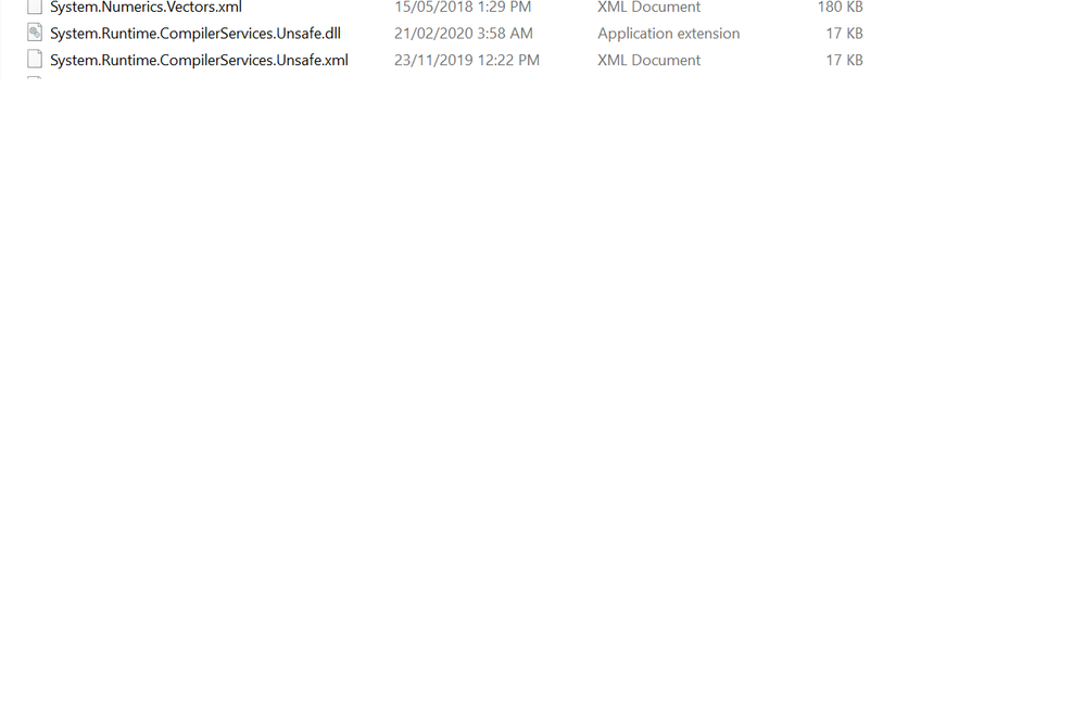

Do you have a reference to System.Runtime.CompilerServices.Unsafe and is it copied to your output directory (where your plugin dll is)? Also, all your references are for .net framework, right?
frankholidayjunior
Hi M Hannon,
I checked the System.Runtime.CompilerServices.Unsafe is being output to the same directory as my external command .dll
AFAIK all my references were to .netframeworks 4.7.2, microsoft.ml didnt have any incomaptability issues either i could compile in that framework. I did get around this problem by reading the console output. And i sent arguments to the console aswell.
