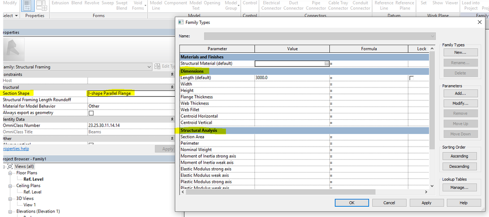

RPTHOMAS108
@Anonymous in Revit 2015 standard section shapes I believe had only just been introduced and therefore their adoption by family authors was likely incomplete or not at all. Perhaps out of the box had them completed, unsure.
You can check the families you use and see if the standardised section shape related parameter values have been filled out. In lieu of this you will have to create a fall back mapping system (where you relate the SP GUIDs to their meanings yourself) i.e. can make a generic data grid with SP GUID on the left and meaning to your application on the right.
If you are using standardised parameters then you need to refer to the ...Revit.DB.Structure.StructuralSections namespace, pick class that relates to the section shape of the family and use the properties of those sections. You can also still get these parameter values via the standard parameter fetching methods, use their built in parameter id such as: STRUCTURAL_SECTION_COMMON_HEIGHT.
