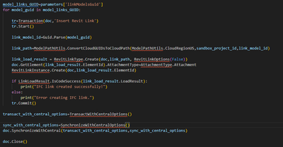

So, I got a weird issue... I'm using Revit 2022 API, and I have some GUIDs that I obtain trough APS on a different program.
My issue is: I link my models as an attachment, then synchronize and publish, but those models don't show up in BIM360. Then, if I open the cloud model (the links show up correctly in a 3D view), I sync manually using Revit's UI, and then publish using Revit's UI, and then I can see those links.
I don't change anything in the Revit model when I open it manually, I just sync and publish manually and then the links show up.
This is how I'm trying to link them and sync it. As you can see, I set those links as attachments.
Do you guys have any idea if I should be doing something else before syncing and publishing?
I've already tried adding a regenerate before syncing but it didn't do anything.
My link models GUIDs are Revit Cloud models obtained from IFC files.

I found a pretty hit or miss workaround which is, after closing the document: re-opening the same document, syncing and then I send the order to publish on APS.
As I said, it's pretty hit or miss, I'll maybe add some more open-sync-close steps in a loop and see if I get a more consistent output.
