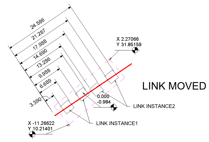

Hello!
I am a big fan of the ReferenceIntersector filter, finding elements like that is great!
In this post Jeremy Tammik explains this slow filter and the use of combinations of filters:
https://forums.autodesk.com/t5/revit-api-forum/how-to-use-the-elementintersectselementfilter-from-th...
The combination of BoundingBoxIntersectsFilter and ReferenceIntersector can boost the performance of the slow ReferenceIntersector Filter. Even when using linked-models, the ReferenceIntersector can find the link (at first) and the ReferenceWithContext can give you information about the element in the RevitLinkInstance, works great!
When the RevitLinkInstance is NOT moved, the combination of ReferenceIntersector+BoundingBoxIntersectsFilter works great, but when the RevitLinkInstance is moved, no elements are found.
It looks like the BoundingBoxIntersectsFilter not only filters elements in the opened model, but also the elements in the linked model, by check of coordinates or something.
But when the RevitLinkInstance is moved in your opened models, the coordinates are different, the BoundingBoxIntersectsFilter fails.
See attached image, the linked model is not found within the BoundingBoxIntersectsFilter, by the ReferenceIntersector, but is is there!
The Ray realy hits the linked model, the linked element, within the (local) BoundingBoxIntersectsFilter, but nothing is found.
Looks like the ReferenceIntersector+BoundingBoxIntersectsFilter fails on moved RevitLinkInstance.
Am I doing something wrong or does the BoundingBoxIntersectsFilter fails om then moved (elements in the) RevitLinkInstance ??
Thanks Again,
Chris Hanschen

Message 6 of 21
RPTHOMAS108
Filters work within the document so the bounding box is relevant to the space within that i.e. within link document. The link document doesn't know where it is placed in the host document since that is information associated with the link instance in the host document. Hence that is why the filter doesn't know.
The ReferenceIntersector is not a slow filter or any kind of filter it is a utility to strike something with a ray based on origin and direction. The ReferenceIntersector works within the current document where the various links take up a final specific known position (so it is not analogous to an element filter or limitation of such).
The RefereceIntersector will only find things based upon visibility of the elements in the 3D view provided. So that is one way of filtering beforehand what the RefereceIntersector strikes. Although visibility control of elements in links via the API is fairly limited still. Regarding links the suggestion I believe is to transform the bounding box into the space of the linked document.
Not sure I follow your issue with transforming the bounding box to the link space. If you have a link instance in multiple positions then you only need to check one instance of that link. Since transforming the box into the link document will result in the same target position in the link document? Depends how you are using the bounding box filter to begin with? You are interested in a certain region so what link instances are in that region to transform the box into and check for initial elements?
The only real limitation as mentioned is that the bounding box is parallel to the document space and this may not be the same in the linked document as the host document. Since object you use is 'Outline' and that doesn't have a transform to give you an alternative orientation for the model it is used in. However it is a rough exercise for an initial coarse result. I would probably create the bounding box corner points in the host document for a box aligned with the link transform axis, so that they match up when transformed into the link. If you create the corner points based on a box aligned with the host document then it may not represent the same when those points are transformed into the associated linked document positions.

RPTHOMAS108
You know the link instance position via its transform so you know where the bounding box needs to be relocated to suit that. The below code demonstrates using a logical or filter with bounding box for each inverse link instance location.
I tested this on two instances of the same link relocated from where they were inserted (X=0, Y=0):
    Private Function Obj_230305a(ByVal commandData As Autodesk.Revit.UI.ExternalCommandData,
ByRef message As String, ByVal elements As Autodesk.Revit.DB.ElementSet) As Result

Output:
432129, 432128, 6.68864267244516
432129, 432128, 3.38973099408717
432129, 432168, 13.2864660291611
432129, 432168, 9.98755435080315
432142, 432128, 17.9884761277055
432142, 432128, 14.6895644493475
432142, 432168, 24.5862994844214
432142, 432168, 21.2873878060635
Eight faces, two linked element ids in each of the two element ids representing link instances i.e. four unique permutations of ElementId, LinkedElementId.
Can be noted that the faces are not returned in order of proximity.
Note no link instance in position where bounding box points are transformed to in host document:
