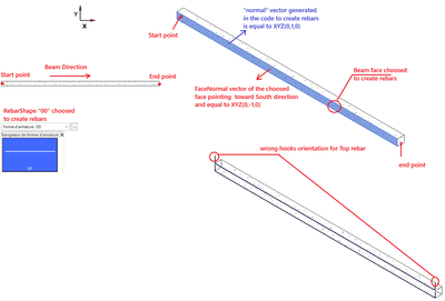

Hi everyone, @longt61
I'm using Dynamo inside Revit and IronPython 2.7 , and I'm attempting to create longitudinal rebars (Bottom and Top rebar) for a stright beam which is oriented in +X direction as you can see in the image below, and this by using CreateFromCurves Method.
As you can see in the image below, in my code I grabed the South beam face where its FaceNormal is XYZ(0,-1,0), then to create rebars I set normal vector to be the opposite of FaceNormal and equal to XYZ(0,1,0)...however I'm conused and unable to set correct RebarHookOrientation for both ends in Top rebar, which are always oriented toward UP (+Z) instead of Down (-Z), even though I tried  to set all possible orientation combinations in my code (Left/Right, Left/Left, Right/Right, Right/Left)!!
Please check my code below and guide me to well understand RebarHookOrientation priciple to be able to solve my issue

Hi @REDO10 , thanks for the direct message.
I only have a few experience with Revit rebar in older versions, newer ones such as 2025 and 2026 might be a bit different, so take my opinions with caution :)) .
The thing I would point out from your code is that when you trying to get top edge and bottom edge from the "South" face, their direction would conform to a complete loop. Which means, the 4 edges will be clockwise or counter clockwise, a.k.a the direction of top edge and bottom edge is opposite. Therefore, applying the same input for rebar hook for both of them might not work. Furthermore, Revit rebars have some quirks (in the older version, at least), so you need to do some extra work sometimes .
To directly solve your issue, I would suggest these following:
1. Try check if the direction of top line and bottom line are opposite. If so, try to use different inputs for them.
2. If it does not work, you might want to try the overload method for "CreteRebarFromCurves" where you can specify the rotation for rebar hook. I not sure about python, but it should wrap the original C# Revit API here and here . Please read the remarks carefully to find the one that suits your need.
Bonus: here are a few things to keep in mind:
1. Revit has some quirks, where some of the parameters are affected by or become visible/ invisible by other parameters
2. Some settings or geometry are not available for modification until you have regen the document or ui document
3. Your rebar might be affected by the rebar constraints, which will "snap" rebar to some special points such as: the framing 's rebar cover (the distance from the outer most face to where you can validly placed a rebar to ensure that the concrete will cover the rebar in real life), the other rebar 's bend point / mid point / start-end points, etc.. Therefore, even if you calculate everything correctly, your rebar still "snap" to those points and change location/ rotation/ normal vector unexpectedly. I would suggest you create some model lines to visualize your rebar locations, normal vector, etc.. to see if your input is correct, then try to analyze the Rebar constraints manually and programmatically via RebarConstraintManager.
Hope this helps.

sorry for the late reply, I was quite busy for the past few day.
Firstly, make sure you understand the normal vector, the direction of the rebar. Any 3D coordinate consists of 3 axes: X, Y and Z. You can consider rebar direction is X axis, rebar normal is Z axis. These 3 axes conform to the right hand rule (you can look it up online for visualization):
  • Rebar direction / X axis is the index finger
  • Y axis is the middle finger
  • Rebar normal / Z axis is the thumb, which is the cross product of X and Y axes.
  • In your case, the rebar hooks:
    - Left hook should be the same direction as Y axis
    - Right hook should be the opposite direction to Y axis.
Therefore, you can calculate the hook direction to see if it suits your need, otherwise, negate the normal. I will try to use the left case in your first picture to demonstrate. All of the vector will normalize to unit vector (vector with length = 1):
Consider the top bar
  • rebar direction (X axis of rebar) = (-10, 0,0). Normalize() = (-1, 0,0)
  • rebar normal (Z axis of rebar) = (0,1,0)
=> Y axis of rebar = X.CrossProduct(Z).Negate() = ( -1, 0, 0).CrossProduct(0, 1, 0).Negate() = (0,0, 1) (pointing upward direction)
if you set it to left hook, the hook should point upward. If you set it to right hook, the hook should point downward.
Then, you can consider changing the normal vector or the left/right settings of the hook to create rebar.

Message 8 of 17
longt61
@REDO10 like I have proposed before, could you check the rebar constraint to make sure it was properly constrained as shown in the images below? Besides, you can check it in the code using the RebarConstraintsManager
Message 9 of 17
REDO10
Hi @longt61
@longt61  a écrit :
The right hand rule applies to X_axis.CrossProduct(Y_axis) = Z_axis, you can not switch the order of the vectors so that "it seems fit". What you thought and demonstrate in the image is the left hand rule.  Therefore, if X_axis = (-1,0,0) and Z_axis (0,1,0), Y_axis = (0,0,1) so that X_axis.CrossProduct(Y_axis) = Z_axis, not that X_axis.CrossProduct(Z_axis) = Y_axis.
Maybe I wasn’t very clear, but I think we can agree on this:
When applying the right-hand rule, the result of the cross product points in the direction of the thumb. In my case, the direction of the bar is (-1, 0, 0). The normal vector of the plane where the rebar is placed can be determined by changing the rebar distribution from "Single" to another rule.
Here, the normal vector is (0, 1, 0), which points north (+Y), because I selected the south face of the beam as the placement constraint (to prevent distributed rebars from going outside the beam). Based on this:
(-1, 0, 0).CrossProduct(0, 1, 0) = (0, 0, -1)
This result gives us the vector that defines the Left/Right hook orientation.
Could you please confirm if my understanding is correct: since the cross product result is (0, 0, -1), does that mean "Left" orientation points downward in this case?
I'll test your code and compare it with mine to see if I get the expected result.
Thanks.
Message 10 of 17
longt61
hi @REDO10 , I hope my code works for you, otherwise, please try to research the rebar constraints to see if it affects your rebar locations.
As for the vectors issue, let us break it down into 2 parts:
1. The idea of cross product of the right hand rule:
    yes, you absolutely correct.
2. Its application:
    I think what you confuse is that the right hand rule only apply in one way: X_axis.CrossProduct(Y_axis) = Z_axis. Z_axis is always the direction of your thumb. You cannot change the order of the equation. What you are using is X_axis.CrossProduct(Z_axis) = Y_axis. You have switch the place of Y_axis and Z_axis. You can try to place your index finger to the direction of X_axis (rebar direction) and your thumb to the direction of Z_axis (normal). Then, the middle finger is the direction of Y_axis according to the right hand rule.
    In other words, the issue is "given X and Z known, find Y that satisfies X.CrossProduct(Y) = Z" while you are trying to solve "find Y that satisfies X.CrossProduct(Z) = Y".
I hope this is clear enough.
Message 11 of 17
REDO10
Hi @longt61
I'm sorry to ask again, but I'm still confused, so let me explain:
@longt61  a écrit :
2. Its application:
I admit that I was initially confused about the order of the Y and Z vectors in the cross product equation. I now understand how to correctly orient the X and Z vectors (which are given), and how to determine the Y orientation by following the direction of my middle finger representing the Left orientation for the hook at the start or End(0) of the bar (whether it's facing upward or downward.)
However, in my code below (where I reproduced the exact same logic as in your code, with slight modifications to get the desired BarType and HookType), you can see in the image that I still get the hook reversed compared to your result...even though I made sure to replicate your case by taking these key points into account:
  • As you suggested (and as shown in the image), I ensured the rebar is properly constrained, just like in your case.
  • I printed out the normal vector and the rebar direction to confirm they match your setup, where:
       - The normal vector Z is (0, 1, 0)
       - the bar direction X is: Vector(X = 10.000, Y = 0.000, Z = 0.000, Length = 10.000)
Furthermore, I’d like to point out the following:
  • Even when I reverse the bar direction to Vector(X = -10.000, Y = 0.000, Z = 0.000, Length = 10.000) while keeping the normal vector unchanged (0, 1, 0), the hooks still appear unchanged and behave opposite to your case!?
  • The hook orientations read from Revit Lookup are always the opposite of those set in the code. (as you can see in the code I've set the start hook to Right but Revit Lookup reports it as Left, and vice versa.
  • How does Revit determine which rebar shape family to use from the Rebar Shape Browser that matches the hook criteria I've set ? (as shown in the image, the chosen rebar shape is "23") Should I load all shapes from the Rebar Shape Browser and let Revit automatically select the correct one that matches the hook criteria? Or should I delete all shapes except the standard one "00" to ensure Revit creates the desired shape?
Please check my code below:
import clr
import sys

Message 12 of 17
longt61
Hi @REDO10 , could you share the revit file where you had created rebar with all the settings? I am not sure if I can identify and solve your problem, but investigate the current state of the revit file might shed some light into the matter. Please remove all sensitive information as you seem fits. Thanks.
Message 13 of 17
REDO10
Hi @longt61
Please check below my attached model
Thanks.
Message 14 of 17
REDO10
Can anyone help me clear up my confusion about hook orientation?
Thanks.
Message 15 of 17
longt61
@REDO10 sorry for taking too long to reply, I have been scratching my head when my code produce the same result as yours with your shared file, but it works fine with default Revit project file. The causes of the issue are:
1. You have tried many versions of your code, both correct and incorrect ones, in the shared project, and it creates many rebar shapes. You can see that there are multiple rebar shape with "23" name as shown in the image below.
2. Due to there are many shapes in the shared project and you did not tick on the Reinforcement settings as shown in this image, Revit does not take the hooks into account when trying to resolve the shape of Rebar. Furthermore, I set the "useExistingShapeIfPossible" parameter to "true" in the code, therefore, Revit will try to use the first custom shape that satisfies the main rebar segment excluding the hooks.
You just need to tick the checkbox for the mentioned Reinforcement settings, then run the code again to produce the result you want. As you can see in these images, I can create 2 different results using the same code just by changing the Reinforcement setting:
Hope this is not too late for your work.
P/S:
1. I got the result with Revit 2024, so I am not sure about earlier version. You might want to check the settings and API again since your shared file is of Revit 2023.
2. If Revit API does not expose any way to change this setting then I guess this is how it is.
3. You might want to change back to original settings so that it does not affect future manual rebar creation.
Message 16 of 17
REDO10
Hi @longt61
No problem at all ... I’m the one who’s grateful to you for your patience in helping me track down the source of my issue. So once again, thank you!
Like you, this issue was driving me crazy!!...I tried editing the original shape "23" and created two new shapes, hoping that the generated rebar shape would match one of them, where:
  • first I reversed the bar direction to create a "23_reversed" shape,
  • then I flipped the hooks to create a "23_hooks_reversed" shape.
It never crossed my mind that the problem was actually related to the reinforcement settings. As you suggested, I should have checked the “Include hooks in Rebar Shape definition” option from the start. Now the issue is solved, and I’ve tested my code in multiple cases with different hook orientations. I’m getting the expected shapes with the correct hook orientations exactly as defined in my code.
In conclusion, if we want hooks to be included in the generated shape “Include hooks in Rebar Shape definition” option must be checked?...for that and using Revit API, is there a code that ensure this option is enabled by default when starting new project?
Thanks.
Message 17 of 17
longt61
Glad that I could be helpful. And I also learn something new along the way.
As for the Include hooks in Rebar Shape definition”, I have not found any API related to this settings yet. I guess we have to take as it is, and trying to find out more as we work with Revit. When I first start working with Revit and rebar back in 2019, rebar does even have geometry or solid, which is frustrating for checking interference of automate created rebars and existing one. Now, to my surprise when trying to analyze your issue, I find out that rebar have solid, which is great. So, maybe I was looking hard enough, or we can hope for a better future. :))
Cheers, happy coding.
Update: I looked it up and you can use the "ReinforcementSettings" class to modify the “Include hooks in Rebar Shape definition”. Even though this is a project wise settings, it can not be retrieved directly from the "Document" class, which is a Revit quirk and that is why it slips my mind. Furthermore, according to the remarks, you can only change the settings when the project contains no rebars in general. Quite limited compared to the Revit user interface, but there hope in the future. I hope that you can find the similar function in your Python code.
var settings = ReinforcementSettings.GetReinforcementSettings(_doc);
settings.RebarShapeDefinesHooks = true;
