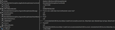

Query: I am trying to place rebars for Generic Model, while placement I am facing below error. Can anyone please guide?
Error:  "host is not a valid rebar host.\r\n Parameter name: host"

Note: Here I am passing below element as host.
Reference selectEntity = uiDoc.Selection.PickObject(Autodesk.Revit.UI.Selection.ObjectType.Element, "Select a Haunch");
Element oEle= document.GetElement(selectEntity);

jeremy_tammik
Can you place rebar in that host manually using the end user interface? If no, it will not be possible programmatically either.

jeremy_tammik
Please solve this issue manually in the end user interface first, before starting to think about an API solution. The API will not enable anything that the UI cannot. The best place to discuss it might be in the structural forum.
