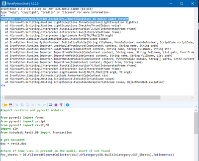

I'm working on running some code inside of the python shell but I keep getting this error message and can't seem to solve it. Whenever I run the code I have (and I'm new at this so explain it to me like I'm 5), I get the error message, "Exception : IronPython.Runtime.Exceptions.ImportException: No module named pyevent". The whole error message is below.
From my google searching I found that I'm supposed to install padas inside of my python enviornment but I have no idea how to do this (like I said, I'm new and learning). Here's the link to the website where I found that.
Thank you for your help!

Good news - I solved it!
You need to add the path to "site-packages" in the RevitPythonShell.xml file.
If it still doesn't work then you will need to point PYTHONPATH environment variable to the same "site-packages" folder , but I think the first step solves it.
rjohnstonBK2JP
@sergey.brezgin that worked! All I had to do was
  1.  Find the file called 'RevitPythonShell' inside of this folder: C:\Users\name\AppData\Roaming\RevitPythonShell\2021 and open with notepad.
  2. insert that line of code: <SearchPath name="C:\Users\name\AppData\Roaming\pyRevit-Master\site-packages" />
  3. Save and close
Thank you so much for the help @sergey.brezgin
