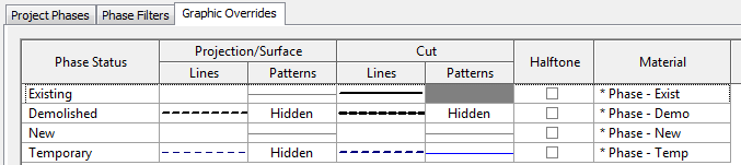

I'm trying to access the settings for Phasing > Graphic Overrides via API.  Something tells me it can't be done.  Am I wrong? Thanks.

Hi. Thanks, but I'm not trying to set the phase of the view.  I'm trying to change the phasing graphic overrides.  The first tab of Phasing can be accessed through the Phase class (although very little can be done), the second tab can be accessed through the PhaseFilter class.  I'm trying to get to the settings in the third tab. Thanks.

I see, I checked if this is accessible through the API and I have found that unfortunately it is not at the moment. There is an enhancement request already in our system to be consider and get it available in a future release of the software. Here is the record number so you can ask for update in the future.
CF-3036: As an API developer, I would like access to PhasingOverrides and its connection to OverrideGraphicsSettings.

Bad news on the status of CF-3036 [As an API developer, I would like access to PhasingOverrides and its connection to OverrideGraphicsSettings], I'm afraid. No business case was ever submitted, no priority registered, no association to any wish list entry in the Revit Idea Station created. Hence, nothing ever happened with it.
I just assigned a priority to it and added a mention of your interest expressed here in this thread.

We have run into a scenario that a client needs to get a copy of OverrideGraphicsSettings based on the
ElementOnPhaseStatus, essentially a method signature of:
View.GetPhasingGraphicsOverride(ElementOnPhaseStatus)
EDIT:
I have found a solution to this (however, somewhat convoluted):
Snoop the Database for GraphicStyle elements that match the names of the ElementOnPhaseStatus - Existing, Demolished, New, Temporary - then inspect the GraphicsStyleCategory to get GraphicOverrides.

Additionally, @jeremy_tammik , the info accessible from there is limited, only Line Weight, Line Color, Material etc. are accessible but Pattern Foreground/Background Overrides and Halftones are not accessible. I even tried View.GetCategoryOverride(GraphicStyleCategory)/GetElementOverride(GraphicStyle) but the OverrideGraphicsSettings object returned contains incorrect values (seems default). So I wonder where we can correctly get the OverrideGraphicsSettings object in regards to different ElementOnPhaseStatus
