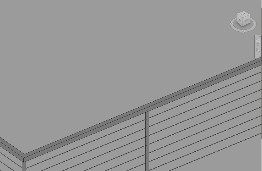

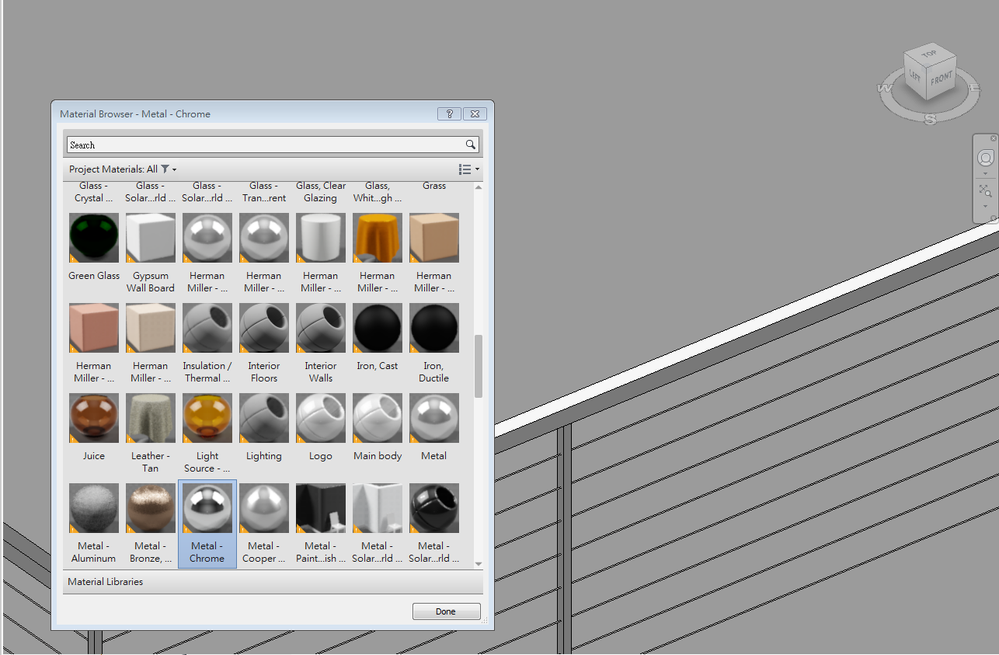

2021-06-18_092530.png2021-06-18_092608.png2021-06-18_092702.png2021-06-18_092752.png2021-06-18_092824.pngHi Jeremy,
You are right. Somehow, painting sub elements like stair's landing or runs, there is no exception be thrown like painting elements does. It's interesting.  I have modified the code to be able to paint stair's landings or runs correctly without error. I added a function to test which element the picked face is belong to, so it doesn't need to run both loops to paint. The function  is set to paint any face, so it's also a sample to show how railings' face can't be painted like UI does. I use Revit sample project for demo, so you can easy reproduce same scenario at your side. The last picture is showing error message using this function trying to paint Railings' top rail. The second to last picture is showing UI successfully painting same place.

Hi Jeremy,
Thanks for cleaning my messy code. I have tested your code  and it worked fine. The reason for only painting one face is that I want to paint selected face like UI does. I just made a free app on Autodesk Exchange using this function to paint face without the need to open paint browser, called CopyPaint. It might take a couple days for publishing. For sample project, I use built in sample "rac_basic_sample_project.rvt ".
Demo of CopyPaint:https://www.youtube.com/watch?v=mN_XyFVpf48
