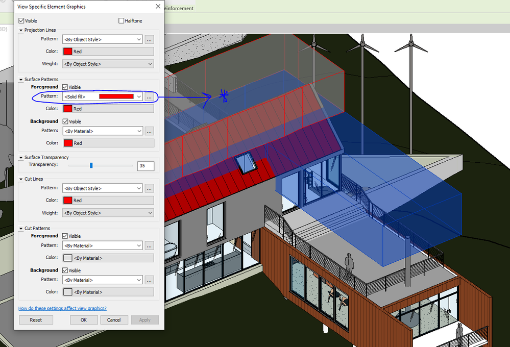

I am overriding the graphics settings for each of my DirectShape objects I seem to be able to only control the color of the lines, but I can't get access to actually changing the color of the surfaces which I also need, only their transparency.
The only way I could do it is  via the Revit UI  is there any way I can change the forground pattern to solid via the API?

@jeremytammik  thanks again for getting back!
When I create my Direct Shape geometry as a  Generic Mass Category, under its properties palette it does not have a Material and Finishes Parameter,  the option to click Edit Type is grayed out  and even  the Edit In-Place button does not appear under the Modify | Generic Models ribbon. In Addition, what I do get instead is some sort of default structural property and a Rebar button replacing the Edit In-Place button.
In contrast I modeled by hand a simple extrusion in Revit and I put it under the the Generic Mass Category as well. This element does have all the missing parts that my direct shape lacks
So if I try to access the Direct Shapes Material Parameter via
var p =  ds.get_Parameter(BuiltInParameter.MATERIAL_ID_PARAM);
p in this case will always be null because the material parameter does not exist.
so doing
Set(material.Id);
will not be possible.
Another method I tried was to create a Shared Parameter file. The first step works, in the sense that I do get a Material parameter in the properties pallete. But it does not fully work because I cant Edit In-Place my Direct Shape to succesfully make  a change in its Material.
Do you have any idea what could be wrong?
