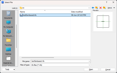

Mohamed_Arshad
Hi @lrsmns
    you can't able to set default location in FileOpenDialog, It will take recent file location as default location. Kindly check the below image and link for additional reference.
Reference Image
URL: https://www.revitapidocs.com/2024/efe4f212-6400-eaec-9263-1665ba9c163f.htm#:~:text=The%20folder%20lo...
Hope this will Helps 🙂
