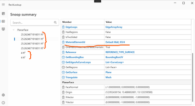

Hi everyone,
I retrieve the MaterialElementId for every face of the element's solid, but I notice that some faces do not have a MaterialElementId assigned. In the attached pictures, you can see RevitLookup for an architectural column. There are faces with and without a MaterialElementId; however, in Revit, all faces appear to be assigned with one material. I would appreciate it if somebody could explain this.

Pure conjecture, just for fun:
  • Only visible surfaces are assigned a material id, because it makes no sense for invisible surfaces
  • Some surfaces are caused by intersections or joins with other elements and are therefore hidden, not visible, covered

Thank you for quick reply,
As seen in the picture, there are six faces of the column, all of which are visible and not hidden.
jeremy_tammik
Aha. Does the column display as expected? Are all six faces represented correctly? What material do they display? Maybe some of them have a default material assigned by category or some other overriding property, whereas others have a specific material assigned?

I guess that's how Revit works.
If you create a family with geometry and do not assign any material, ElementId.InvalidElementId or -1 is assigned in the geometry.
And I am pretty sure Revit uses the Material in the Category in the document as a default Material to display to the user.

This material is contained in a private property that is not officially available, you can see this if you enable Non-public in RevitLookup. Try to check the property value in Solid or other geometric objects as well
