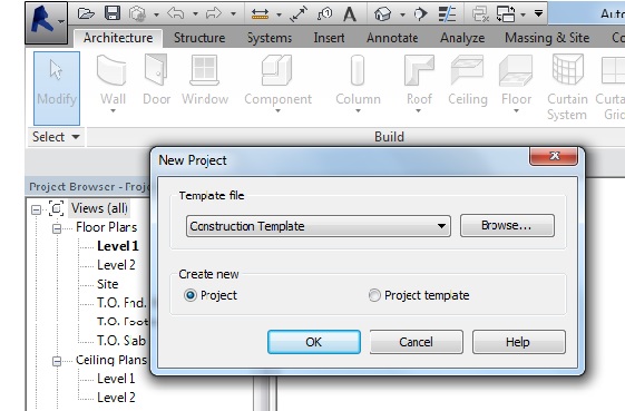

hi everyone.
I am developing a REVIT ADD-IN and need to open the dialog box 'New Project'. Could someone give me an example of code that lets you do this?

Dear Marcos Mateo,
The Revit API provides an API call to programmatically create a new project, the Application.NewProjectDocument method, but that obviously does not display the dialogue that you are after to prompt the user for the new project name.
Your only other official Revit API option that I can think of would be to use the PostCommand method to launch the built-in Revit 'new project' command, if it is postable at all. Here is an explanation of how to retrieve its command id from the journal file and check whether it is postable, i.e.
http://thebuildingcoder.typepad.com/blog/2013/10/programmatic-custom-add-in-external-command-launch....
You can also look at the PostableCommand enumeration that lists all of the built-in commands which can be posted by an API application.
If it is not postable, you might be able to use the native Windows API or .NET libraries to simulate the user clicking on the appropriate Revit menu entry. That would be unsupported and at your own risk, of course.

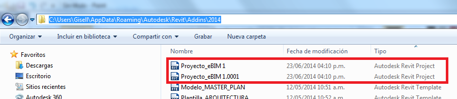

hello jeremy
I tried my Revit add-in developed. NET 2012 open a new project (*. rvt) using a template (*. rte). but an error message is displayed.
although exist error, the application creates 2 files with the same name in my windows directory. Might help me solve this problem
