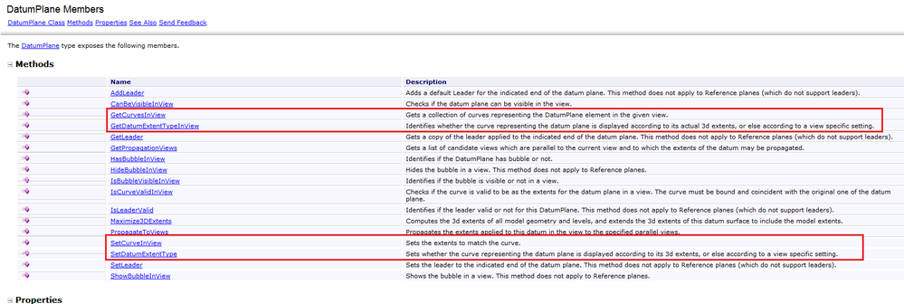

aignatovich
Hi! Yep, it is possible, look at this methods of DatumPlane class (it is a parent class for Reference planes, levels and grids)
strsuraj
Thanks @aignatovich, thats exactly what I was looking for.
