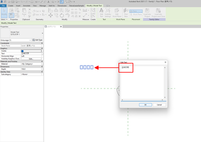

I'm trying to create "ModelText" in Japanese in "Family Editor" but it's not displaying properly. But my colleague's computer can display properly
Please help me to solve this problem

Thank you for reminding me. I discovered this when programming an add-in that automatically assigns text to a family.
I solved it by changing the region format of the Window to Japanese.
