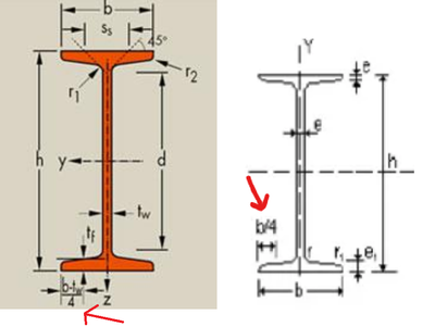

I am importing connection details from Revit 2023 and for Autodesk.AdvanceSteel.Profiles.ProfileTypeI the flange thickness location is missing (since H3 is the flange's slope, then, that property is needed).
Please also take a look at StructuralSectionGeneralI which is similar and it contains that property.

You would need a diagram of these section types to determine what is and isn't required. I don't know if advanced steel provides that somewhere.
However if the flange thickness is counted as a minimum then it would start at the top of the toe radius or likewise if it were a maximum then it would start at the bottom of root the radius (for bottom flange). So in those cases, you wouldn't need a thickness location since you have slope, start point and end point. The slope gives you the tangents of the fillets so you can establish their start and end angles and so their start and end points.

The distance I am talking about depends on the Standard/Country, for example:

I've done some further investigating of the advanced steel access data base found at:
C:\ProgramData\Autodesk\Advance\Data
And it appears that the flange thickness is measured at B/4 consistently for:
UK RSJs, European IPNs and US S-shapes.
The only one that was slightly out was comparing the access database value for a S12x50 (which appears to equate to S310x74) in the metric Revit family of that US section. The US S shape Revit family had rounded values, so I put the slight difference down to that. That is a 12" deep section of unit weight 50 pounds per foot (74 kg/m) apparently.

From your researches, I'd assume B/4 for every I-H sloped flange profile (which is fine for IPN's but not for US Shapes 🙂 )
