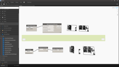

Hello everybody,
First of all, This is my first post on Autodesk forum.
I am trying to achieve extracting line from AutoCAD inside Revit using only RevitAPI. I uses the way shown in the post (link below). However, the lines ended up showing at different location compare to AutoCAD inside Revit.
https://forums.autodesk.com/t5/revit-api-forum/automatic-column-creation-from-imported-cad-drawing/t...
I decided to check the location of curves inside Dynamo,
First, I converted my Revit lines to Dynamo Lines using Python script
Second, I uses a nodes from BimorphNodes
At the end, I find out that lines from Python script is incorrect and yet BimorphNodes have the same location of AutoCAD shown in Revit.
May I know is there anything wrong in my Python script ?
Thanks in advance.
Here is my python script:

319 Views
1 Reply
Reply (1)
naveen.kumar.t
Autodesk Support
Autodesk Support
Hi @hengjiyong ,
I think it is better to ask Revit dynamo-related questions in the Dynamo forum.
https://forum.dynamobim.com/c/revit/12
Naveen Kumar T
Developer Technical Services
Autodesk Developer Network
