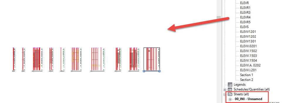

I need to place many section view in 1 sheet, ordered from left to right , separated a certain distance
In the following photo shows what idi manually
Any suggestions, code or article.
greetings and thanks

If you written a code that show us your trial to achieve your target, we would be happy to help you to a proper direction.
but basically you need
1. to create/Get a sheet view
2. create a view port and assign the view you need to place on the sheet
3. get the viewport width
4. place the view port on the sheet at a distance greater from the sum of all previously placed views.
hope that helps
