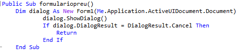

Hello
I can not execute the form from   me.application
any suggestions?
regards

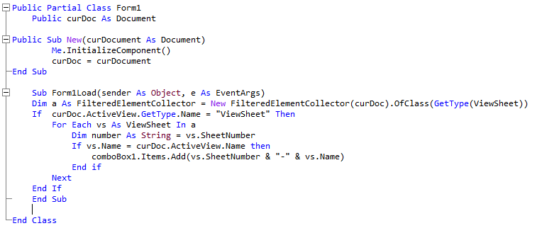

Hello.
You're trying to get the "Application" member from the form class, that's not going to work. I don't know the best solution, but this worked for me:
Form:
Public Partial Class Form1
		Inherits System.Windows.Forms.Form
		Private m_uidoc As UIDocument
		Public Sub New(uidoc As UIDocument)
			m_uidoc = uidoc
			InitializeComponent()
		End Sub
		Private Sub Form1Load(sender As Object, e As EventArgs)
			Dim doc As Document = m_uidoc.Document
			Dim collector As New FilteredElementCollector(doc)
			collector.OfClass(GetType(ViewSheet))
			For Each vs As ViewSheet In collector
				Dim vNumber As String = vs.SheetNumber
				If vs.Name = doc.ActiveView.Name Then
					comboBox1.Items.Add(vNumber & "_" & vs.Name)
				End If
			Next
		End Sub
	End Class
ThisDocument:
Public Sub ComboBoxForm()
			Dim dialog As New Form1(Me)
			dialog.ShowDialog()
			If dialog.DialogResult = DialogResult.Cancel Then
				Return
			End If
		End Sub
P.S. I converted the code from C# to VB.NET.

rodrigohbm
Thank you
but I had to adjust the code
being of the following way:
for ThisDocument
regards.
