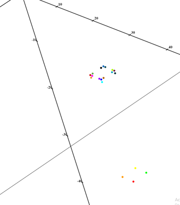

I also tried to visualize the coordinates using a 3D plotter and it came out like this:
As you can see, there are some coordinates at the top face which are actually not the vertices. What is the explanation to this?

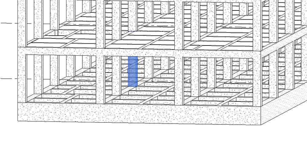

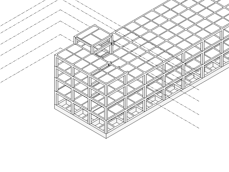

First, this is how my building looks in 3D:
Next, I managed to get the ElementId of the spcific column with 19 corners (the ID is 297426), it is highlighted below:
The highlighted column w/ 19 cornersThe highlighted column w/ 19 cornersThe respective column in Isolated ViewThe respective column in Isolated Viewthe column viewed from top of the 3D view that has been cut down by section boxthe column viewed from top of the 3D view that has been cut down by section boxzoomed inzoomed in
The column seems rectangular to me, is there any cuts caused by touching with other elements? (beams or slabs?)

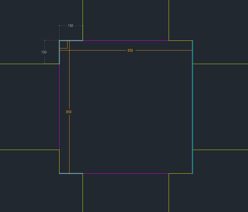

I just did a further calculation on the coordinates of the 19 corners and I find that some coordinates at the top arrangement are 15 cm from each other. 15 cm is the exact thickness of the slabs adjacent to the columns and 15 cm is also the distance between column corners to the slab corners at their meeting point:
As an illustration, please see the following constructed 3D model from the 19 corner coordinates:

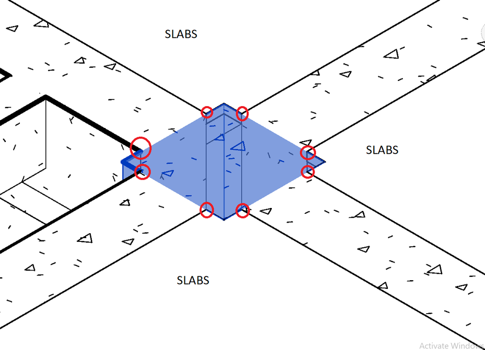

Point 1 to 4 are located at the bottom face of the column (they are on the same height), point 5 to 16 are all located at the topmost face of the column (they are on the same height), while point 17 to 19 are located 15 cm below point 5 to 16. 15 cm is exactly the thickness of adjacent slabs to the column
Furthermore, I can confirm that point 5, 8, 11, and 14 are the correct corners of the top face of the column, while point 6, 7, 9, 10, 12, 13, 15, and 16 are the meeting points between the slabs and the column. What I mean by meeting point between slabs and column is shown below:
The meeting points are circled in redThe meeting points are circled in red
The distance between column corners and the meeting points circled in red are exactly 15 cm (150 mm) as shown in my CAD drawings:
And I can confirm this because the distance between column corners (point 5 for example) to the meeting points next to it (point 6 and 16) are also 15 cm.
These facts indicate that the these incorrect corner coordinates are most likely caused by the slabs, but how did this happen and how do I fix this?
