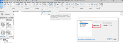

IsRebarInSection(View view) returns true only if the view is a section or elevation and the view plane is cutting at least one of the rebar curves, false otherwise.
This API function is the correspondent of this UI option:
In your case,  to see that the straight bar is shown as a point you can verify this on your own. You can get the centerline curves like this rebar.GetTransformedCenterlineCurves(false, true, true, MultiplanarOption.IncludeOnlyPlanarCurves, 0);, You will get only one line. If the line’s direction is parallel with view’s direction it means that the bar is shown as a cross section, false otherwise.
