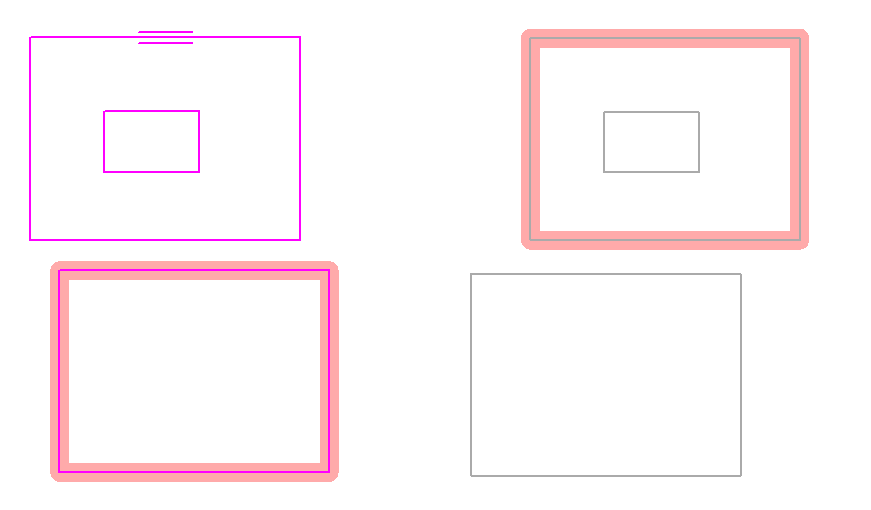

I created a version of SortCurveLoops that converts the XYZ points to UV points, then works on planar loops. I only tested it with a few cases where ExporterIFCUtils.SortCurveLoops fails, and it works well. I will start using it and see if it breaks in the next weeks.
My function takes in input a Face instead of a list of CurveLoops, because all the curves are tessellated and converted to UV. The Face is used for both finding the CurveLoops and converting to UV.
If there are outer loops contained in other outer loops (like in the third snapshot), the innermost loops are first in the resulting list.

I think the projection of the curved Face on XY plane makes the IsCounterclockwise not robust. I tested this method on the following faces and the faces at the opposite direction, and I got opposite result to determine OuterLoops and InnerLoops so the algorithm return a wrong value half the time (wrong result for opposites faces in this example). My tests are in Revit 2022.
To have a more robust solution, I used the projection CurveLoopUV perform with ExportedIFCUtils :
ExporterIFCUtils.SortCurveLoops(allLoops.Select(x => x.Loop2d).ToList()).Select(x => x).ToList();
After this, I perform a CustomEquals between the curveLoops (I compare their Curves order, and for each Curve their Type and their EndPoints XYZ with a Tolerance).
