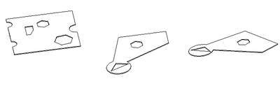

I try to determine for all types of surfaces what is the outer Edgeloop.
Is it always the first one on the face.EdgeLoops?
If not how to find it?
Philippe.

The area approach mentioned in the above link is probably more reliable but I had an alternate idea based on getting all co-ordinates linked to the edge loops they are from and then finding the minimums in a certain direction. Below I've taken min.x but but same would apply for min.y, max.x and max.y
I could not think of a situation where if you convert the 3D co-ordinates of each edge curve to a co-ordinate system of the plane you would end up with a min.x for the outer loop greater than the min.x for the inner loop. Similarly the max.x of the outer loop should be greater than the max.x of the inner loop. This appeared to be true for most cases but then there was the issue of circular curves where the two end points could be further back than a point projecting into the centre of the curve. So I decided to treat cyclic curves differently by checking for min.x along the curve.
I came up with the two below functions one for planner faces and the other for faces in general. They both seem to give reliable results on the cases in the image below (based on expected edge counts for the outer loops). However there may be a case that fail. The parts related to co-ordinate transformations may need looking at (there may be better approaches). I checked the z of each transformed point to see that it was 0 or virtually 0, so seems to be as expected.
For the more generalised method I'm using API functionality which projects a point onto a face, I was expecting some possible intersection errors since I'm checking points on the boundary of the face. I've not checked such things in detail.
In summary the area method mentioned in link is likely better and more reliable, not sure which is faster.

Dear Rpthomas108,
Thank you very much for sharing this nice idea and implementation!
It makes sense to me. Serious testing will be in order 🙂
I hope Philippe found it useful. How sad that he does not say.
I have a couple of suggestions:
  • When you say 'planner' face, you presumably mean 'planar'.
  • Why just handle cyclic curves the way you do? Don't arcs deserver the same treatment, even if they are not cyclic? And other non-linear curves?
  • Instead of using `C.Evaluate` twenty times over, you could call the curve Tessellate method. That would do it for you. It also handles the case of a linear curve gracefully, returning just the two end points, so your MinU function could be shortened and simplified.
Cheers,
Jeremy

          if( min < uMin2 ) { uMin2 = min; }
        if( uMin2 < uMin )
          uMin = uMin2;
          eaMin = a;
      return eaMin;
    public static EdgeArray PlanarFaceOuterLoop( Face F )
      PlanarFace face = F as PlanarFace;
      if( face == null )
        return null;
      Transform T = Transform.Identity;
      T.BasisZ = face.FaceNormal;
      T.BasisX = face.XVector;
      T.BasisY = face.YVector;
      T.Origin = face.Origin;
      Transform Tinv = T.Inverse;
      EdgeArray eaMin = null;
      EdgeArrayArray loops = F.EdgeLoops;
      double uMin = double.MaxValue;
      foreach( EdgeArray a in loops )
        double uMin2 = double.MaxValue;
        foreach( Edge e in a )
          double min = MinX( e.AsCurve(), Tinv );
        if( uMin2 < uMin )
          uMin = uMin2;
          eaMin = a;
      return eaMin;
