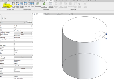

I'm developing an addin for importing geometry into Revit, and I currently have it importing everything as Generic Models using DirectShape, but I'd like to import the geometry as masses instead of generic models.
I was hoping that this would be as simple as making this change:
Before:
var elementId = new ElementId(BuiltInCategory.OST_Mass);
var ds = DirectShape.CreateElement(doc, elementId);
ds.SetShape(brepBuilder); // where brepBuilder is an instance of BRepBuilder
After:
But I'm getting an exception with the message "An internal error occurred" on that SetShape call.
Is there something additional that I need to do for this to work with OST_Mass, or is there a different built-in category that would be more appropriate here?

HI @jamesbvaughan
     I think you have miss something in BrepBuilder. I copy the sample code from Revit Docs and Changed the element id to mass. It works for me. Kindly refer the below code for additional reference.

                DirectShape ds = DirectShape.CreateElement(doc, new ElementId(BuiltInCategory.OST_Mass));
                tr.Commit();
Reference Image:
Note:  Make sure you enable the Mass Showing.
Hope this will helps 🙂

Hi Mohamed, thanks for the quick reply!
It turns out that the exception I mentioned was actually an unrelated issue, and my problem was that I hadn't enabled Mass visibility in the project. Thanks for suggesting that.
