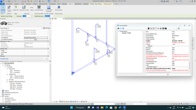

Hola, por trabajo ,deje de trabajar en IPipeFittingAndAccessoryPressureDropServer.Creo que es muy interesante crear un complemento por esa via .Por eso lo volvía retomar.
Solo,por ahora tome IPipeFittingAndAccessoryPressureDropServer,para crear un esquema externo.Pero no se,que pasa,que no lo crea.Que me estas faltando?
Aquí estas el código, si alguien pudiera ayudarme.
Ya estuve mirando el UserMepCalculation,pero ahí no lo crea,aunque si reutilice alguno código.
Hi, because of work, I stopped working on IPipeFittingAndAccessoryPressureDropServer. I think it's very interesting to create a plugin that way. That's why I started it again.
Just, for now, take IPipeFittingAndAccessoryPressureDropServer, to create an external schematic. But I don't know, what happens, that I don't create it. What am I missing?
Here is the code, if someone could help me.
I have already been looking at the UserMepCalculation, but I don't believe it there, although I did reuse some code.

jeremy_tammik
In this question, you associate two very different topics. On the one hand, you mention the IPipeFittingAndAccessoryPressureDropServer interface:
https://www.revitapidocs.com/2023/27a15d91-2dcb-41f3-b818-9c6d3c6e17a3.htm
This is an interface class for external servers implementing pipe fitting and pipe accessory coefficient calculation. A typical way to use the external server can be:
  • Implement a server class that derives from this interface
  • Create a new server object and register it with the service, see ExternalServiceRegistry .
  • Assign server to pipe fitting instance.
You sample code, on the other hand, implements and populates Extensible Storage:
https://thebuildingcoder.typepad.com/blog/about-the-author.html#5.23
There is no connection between these two topics per se.
Therefore, if you run into any problems with either of them, I would recommend separating the two aspects, implementing and testing the respective functionality separately, and ensuring that both of them work correctly before trying to make use of them together.
This is a very fundamental and powerful rule of programming (and politics, and many other areas of human activity): divide and conquer:
https://en.wikipedia.org/wiki/Divide_and_rule
