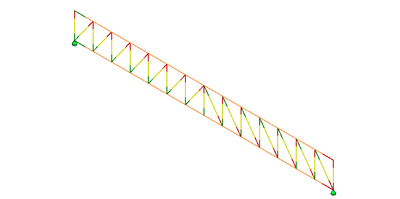

I am  trying to integrate the Structural Analysis Results on Revit. I have been successful in integrating the results for structures with Faces . I have used AVF with AnalysisDisplayColoredSurfaceSettings . For those structures , we were passing the selected face/faces and Revit perfectly displays the analysis results.  Now we are struggling for the structures where we have only Skeleton structures as per attached screenshot . It doesn't have a Face , so we are not sure how to go about it.   I tried with AnalysisDisplayDiagramSettings and passing the usual FieldDomainPointsByXYZ and FieldValues  and calling the AddSpatialFieldPrimitive   without any parameter and then updating the UpdateSpatialFieldPrimitive afterwards . Though I am not getting any error , there is no analysis results displayed on the View.  Now question is whether for structures like these is this the right way to Integrate AVF ?   The samples also only talks about the Faces selection but I couldn't find any sample for these kind of structures.  Please help. Skeleton_Samplee.PNG

1)  Yes, we can achieve the visualization we are seeking using Robot directly. To give you an example , here is the screenshot
of that  in Robot
2) Have you ever seen any kind of AVF applied to stick structures in Revit at all
Answer : --  No. I haven't seen AVF applied to stick structures . But in the link it doesn't include or exclude any specific type of structures.  It quotes "The Revit API provides a mechanism for external analysis applications to easily display the results of their computation in the Revit model. https://knowledge.autodesk.com/support/revit-products/learn-explore/caas/CloudHelp/cloudhelp/2014/EN...
So we were trying to see if AVF can provide  to stick structures as well.. My gut feeling was that it does provide because Robot does display it nicely.   And for face structure we were getting it in Revit as per below screenshot
