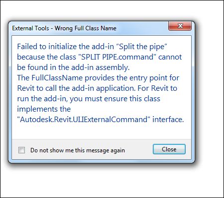

I have developed the macros for Revit 2014 in visual studio 2010 express edition.
For testing purpose i am trying to run this macros in multiple machines...
I tried to copy the .dll file to some local path and i edited the add-in file <Assembly> </Assembly> with same local path and i placed the add-in file in
the below path.
"C:\ProgramData\Autodesk\Revit\Addins\2014".
After launching the revit, if i try to run the macro I am getting error as
erWrong class
I am not getting in which location i have to copy the add-ins and .dll files.
Please suggest where I need place these files.
Please help me to solve this issue.

Few more points i want add to this discussion.
The macro is working fine in the machine where i developed the code.
I copied the add-ins and .dll files to other machine for testing that time i am facing the issue.
I am not very clear where exactly i need place the add-in and .dll files.
please someone help me to solve this issue.

For testing purposes, I usually put the DLL and the ADDIN file both in the same folder located here: C:\ProgramData\Autodesk\Revit\Addins\2015\ (change the 2015 to the version of Revit you ware using).
Then in the ADDIN file set the <Assembly> to the file name of the DLL with no folder path.
This makes it easy to distribute the addin for testing.
