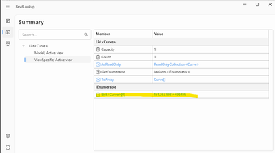

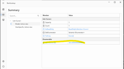

preeti.kumari9TBN6
public static void AnalyzeGridsInSheetViews(Document doc, List<ViewSheet> selectedSheets)
            // Dictionary to store results
            Dictionary<string, List<string>> sheetGridSummary = new Dictionary<string, List<string>>();
            foreach (ViewSheet sheet in selectedSheets)
                List<string> summaryList = new List<string>();
                // Collect all viewports on this sheet
                var viewports = new FilteredElementCollector(doc, sheet.Id)
                    .OfClass(typeof(Viewport))
                    .Cast<Viewport>()
                    .ToList();
                foreach (Viewport vp in viewports)
                    View view = doc.GetElement(vp.ViewId) as View;
                    if (view == null) continue;
                    // Collect grids visible in the current view
                    var grids = new FilteredElementCollector(doc, view.Id)
                        .OfClass(typeof(Grid))
                        .Cast<Grid>()
                        .ToList();
                    int count2D = 0;
                    int count3D = 0;
                    foreach (Grid grid in grids)
                       var type= grid.GetType();
                        IList<Curve> viewCurves = grid.GetCurvesInView(DatumExtentType.ViewSpecific, view);
                        IList<Curve> modelCurves = grid.GetCurvesInView(DatumExtentType.Model, view);
                    if(viewCurves.Count>0 )
                           count2D++;
                        else
                            count3D++;
                        //if (extentData == null)
                        //    continue;
                        //bool is2D = extentData.IsViewSpecific;   // True if the grid is 2D in that view
                        //bool is3D = !extentData.IsViewSpecific;  // False means it’s 3D
                        //                                         //#endif
                        //if (is2D && !is3D)
                        //    count2D++;
                        //else if (is3D)
                        //    count3D++;
                    string summary = $"View: {view.Name} → 2D Grids: {count2D}, 3D Grids: {count3D}";
                    summaryList.Add(summary);
                sheetGridSummary[sheet.Name] = summaryList;
            // Print or log results
            foreach (var kvp in sheetGridSummary)
                TaskDialog.Show("Grid Summary",
                    $"Sheet: {kvp.Key}\n" + string.Join("\n", kvp.Value));
        }Bt for both data are coming modelCurves and viewCurves. I have read 2D grids are viewSpecific.

ctm_mka
First, curious what your need for this type of info is. Second, they are both 3d and 2d, with the Caveat of the 2d being only when cropped by a view, or the user has changed it to 2d (by clicking on the 3d symbol). Third, i would look at the length of line between the model and view specific options as shown. Finally, dont forget about multi segment grids! each segment is a grid itself.
