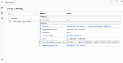

I'm wondering how I can get the host face of a family instance that is hosted to a face coming from a linked document?
In such cases, the Host is set to the linked Element, and if I use the hostFace.LinkedElementId Id, I'm - as the name implies - some kind of Element (Material, DirectShape,Wall,...). But I would want to get the actual face. How would I achieve that?
I tried using the reference living in instance.HostFace directly (both on the main and the linked document), but that didn't work.

You can query the element in the linked file for its geometry. To do so, you probably need to determine its host Document and use the LinkedElementId to open the element in that document.

see if this explanation helps, it is also aligned to what @jeremy_tammik mentioned
In short: to get the host face of a family instance that is hosted to a face from a linked document, you can follow these steps:
1. Retrieve the Host Face Reference: Access the `HostFace` property of the family instance to get the reference to the host face.
2. Get the Linked Document: Use the `LinkedElementId` to find the corresponding linked document and element.
3. Resolve the Linked Face: Use the `Document.GetElement` method with the `LinkedElementId` to obtain the element from the linked document.
4. Get Geometry from the Linked Element: Extract the geometry from the linked element using the `GeometryElement` method.
5. Match the Reference: Compare the reference obtained in step 1 with the faces of the geometry extracted to identify the exact face.

Thanks for the detailing the steps to get there! What would I use to do the matching you suggested in Step 5? Which property do both the geometry face as well as the HostFace reference have in common?
Moustafa_K
Have placed a sample code over here.
Try it and let us know your findings. Basically i am converting to string and comapring strings
