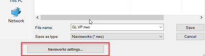

Hi all,
I'm writing a Revit plugin to export NWC files. Before exporting I need to access NavisworksExportOptions to get the current option in Revit. How can I do that ?
Cuong
2,181 Views
18 Replies
Replies (18)
Message 2 of 19
jeremy_tammik
Create a new instance using the constructor:
https://www.revitapidocs.com/2021.1/49a74067-e7da-903b-83ea-fe51274cbd32.htm
Message 3 of 19
Hi Jeremy,
I mean I'm developing a custom Navisworks Settings screen, basically it's the same with the Navisworks Options Editor when user want to export NWC file. I want to take the current Navisworks Options set by user and this options will be populated in my custom setting screen
revit_settings.png   This is Navisworks Options Editor
custom_settings.png  This is my custom settings, I want to take the settings from above screen and show in my screen when I run my own Revit plugin.
Any idea is appreciated

RPTHOMAS108
That interface is not inherent to Revit, comes with Navisworks install or exporter.
For the 2021 version there is a settings text file named:
C:\ProgramData\Autodesk\Revit\Addins\2021\revit_exporter2021.Addin.bundle\nwexportrevit2021\nwcreate_data18\nwexportrevit.cfg.
If there is no better way you'd have to see if you are able to decode the content of this so you can parse it.
I spent a lot of time replicating UI settings for Navis and other forms of export. I would rather have just said 'use this named configuration'. For IFC you can do this since it has named configurations i.e. leave the settings UI to what people are familiar with and just pick the saved configuration in your interface.

Hello @Anonymous @RPTHOMAS108 , are you able to get the current settings of the users from the cfg file (C:\ProgramData\Autodesk\Revit\Addins\2021\revit_exporter2021.Addin.bundle\nwexportrevit2021\nwcreate_data18\nwexportrevit.cfg) When I try to update the Navisworks settings in Revit, the config file is not being updated. Are there other config files where Revit is looking or do I need to do/configure something else. I am also building a tool which aims to export to NWC and get the current user settings first before exporting. Thank you.
Message 13 of 19
RPTHOMAS108
No actually more likely to be in registry settings such as:
Computer\HKEY_CURRENT_USER\SOFTWARE\Autodesk\Navisworks Exporters x64\18.0\GlobalOptions\file_readers\nwexportrevit
Perhaps noted file is for initial values etc.
Message 14 of 19
This cfg file is only for the initial values. I create a xml file to store the current setting.
