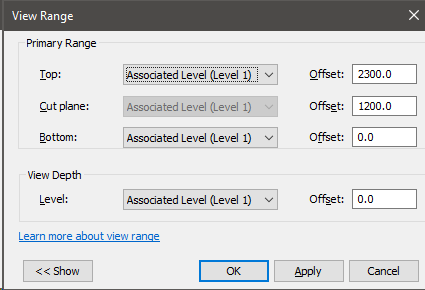

Sorry for the confusion, I could select the Category I want to select using OfCategory quick filter and it works perfectly. The problem is with filtering of elements that belongs not only from active view but also from the view below. I have tried setting the view range limited to active view, but the result is the same.
Please look at this example below:
Active View PropertiesActive View Properties
View Range PropertiesView Range Properties
Task Dialog showing FilteredElementCollector of the View with false elements from the view belowTask Dialog showing FilteredElementCollector of the View with false elements from the view below

Why does it select the elements from wrong views... Eventhough the view properties is limited to this view???

TripleM-Dev.net
The FilteredElementCollector retrieves everything that's visible in the view.
So even if you're floorplan viewrange is set only to a single level (as in you're sample) it's possible something from another level is selected. For example a family that's placed a level lower, but has geometry (or even 2d info) expand beyond the level to the level in you're sample. (or even a element placed a level higher)
If you need all elements of a certain level use the Collector functions to filter for the level.
Otherwise you could even mis a element placed on the level but not visible (detail level, geometry modelled higher etc.)
Sample: Wall, the baseoffset can be set higher then the level it's on, so then you're filter will mis it or select it while it's on another level.
So it depends what you're goal is, select all in view or all placed on a specific level.
Both methods (workable samples even I think) are posted on this forum and also see the SDK samples.
(Filter By Level, Filter By View)
Best regards,
Michel

gprofile
Thanks for your detailed explanation.
So which means if I need both then I would have to collect all the elements in view and filter them by level. However I guess this logic won't work if the elements are dependent on View and independent of Level.
Message 9 of 10
TripleM-Dev.net
Actually really depends what the purpose is of the addin.
If you want all elements of a specific level, but limited by the element only visible in view then there are a few approaches.
You can use a ElementFilteredCollection By view and limit it by a Level(filter)
use: ElementFilteredCollection.Wherepasses(ElementLevelFilter)
Search this for for 'ElementFilter' and 'ElementLevelFilter', I think there will be enough samples (or SDK)
One note though; ElementFilter can be a QuickFilter, but ElementLevelFilter is derived from the slowfilter.
Depending on how many element should be processed, you may limit the ElementFilteredCollection first by a Quickfilter. For example if you only need walls, then filter it first on WallElements.
You can let me know if you need further help with the approach or code.
