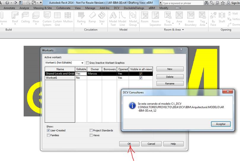

works, but when I click on the "ok" button in the dialog workset revit, run the event documentClosing.
this is a error!!. the aplication should execute the DocumentClosing event when closed the document revit and not to close a dialog box
you cant help me please?

  this is the image the error

All right; So you do subscribe to the event properly. That's good. Now back to the mystery that needs solving be returning to my original questions that have not been answered yet:
1. What kind of document is it that you are closing? Possible answers include: A Local Model, Local workshared model, Central file, Family document, Model template, Family template. Etc.
2. Is it the only one document still opened in Revit at the time of the document being closed? Possible answers: Yes, or No. If No, how many other document are there and what are they?
3. What are the exact steps leading to your closing the document. There is a lot of possible ways, so please be as specific as you can. Include all steps taken, do not leave out any dialog that opens along the way.
I apologies for being so thorough, but the thing is that we have not heard about the document events failing. Events seem to be working for our API users just fine. It must thus be something special there is about your particular case and I am simply just trying to find out what that is. Ideally, if I apply the steps you take exactly here in my work environment I should be able to experience the same problem. And that would be a start for my figuring out a solution.
Thank you

Message 10 of 11
answers:
  1. the document type is local model or central file
  2. generally one, maybe more documents open
  3. the user can close the document: closing de file, closing revit or press crtrl+alt+sup, this last no comun
remember
my plugin is a control activity that counts the time used in the development of a project.
when the user open file revit (*.rvt) the plugin start a timer control and capture file name the document opened
when the user closed the document. the aplication stop timer control, save value timer and save name file opened in my data base access 2010.
this method work with central file, however while using local model and open worksets dialog box and clic "ok" button, or "Cancel Button" o close dialog box, the code add in the documentClosed event run and the activity user is over. but i not closed document. this is the problem, please help me
now i'm using DocumentClosed.

Because if it is the case, it would make some sense to me, actually. It has been reported in the past that Revit sometimes raised document events even for documents that the user does not observe. It is indeed a bug. However, I believe it has been fixed already, and if it was not in R2015 (which I think it was), then in R2016 it will be fixed for sure.
This is what used to be happening: There is a lot more documents open in Revit internally than the documents an end user can observe. Revit often opens temporary documents, especially in work-shared environment. Naturally, such temporary documents are not for the user to see and know about, thus the user should also never receive any events regarding those documents. However, a bug had caused certain events to escape, which is most likely what you still experience.
Fortunately, the fix should be rather easy for you to implement. In fact, you may always want do what I am about to suggest. If you want to do anything at the time of closing a document that you have been tracking somehow (e.g. with a timer, in your particular case), you need to make sure that the closing event you receive is for the document you have been tracking. At your current sample I do not see any code that tries to figure if it is indeed the document that you previously opened in your external command. All I see you tests is the FileOpened variable, but that is naturally not enough. You need to test that your FileOpened is actually the one that is being closed. There should be enough information in the arguments of DocumentClsoing and DocumentClosed events for you to make an informed decision about whether it was “your” document that has just gotten closed. I am afraid you will need to subscribe to both events though in order to get all the necessary information.
Arnošt Löbel
