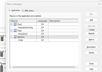

I wrote my first macro in Revit 2023 it's a basic macro, and it works via the macro manager perfectly. But how can I add it to a keyboard shortcut? According to the internet search for the macro name in the keyboard shortcut, I can't see the macro there.

Still, my issue wasn't solved. I can assign a macro to a keyboard shortcut.
sragan
I agree - not solved.   The Macro's are different than the external commands, and they don't appear in the list of keyboard shortcuts.
Doing a google search mostly pulls up circular references to this thread, and other threads about external commands.
I don't believe there is any way to assign a keyboard shortcut to a Macro.  If you want to use shortcuts for your custom code, I believe you will have to convert it to an external application.
