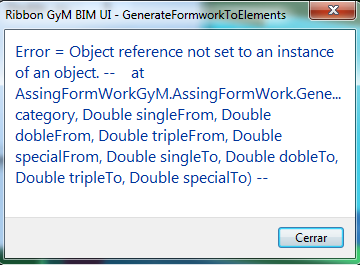

Hi everyone:
I am trying to get the Level ID of the element Beam (Structural Framing).
The 'Revit Lookup' shows up -1 as a value. Where else can I find the Level ID of this element Beam?
Code:
foreach......
Level level = m_revit.ActiveUIDocument.Document.GetElement(fi.LevelId) as Level;
                                double elevation = level.Elevation;
                                string elevationName = level.Name;
Error:

Hello everyone:
I want first say thanks very much for you help.
I found the solution with the comment of the "poleary". I did some changes in the code for to find the Id of the beam:
//Get Level the element
Level level = m_revit.ActiveUIDocument.Document.GetElement(referenceLevel.AsElementId()) as Level;
With this code, is obtained the id of the beam.
