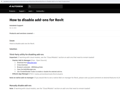

Hi all
I hoping someone might be able to help me understand why I cant seem to find an app manager that will work for 2022 (or any version).
I have tried Autodesk recommended downloads from Diroots and Stantec and both are giving their own specific issues. I am looking top use Dynamo somewhat and it seems that Dynamo isn't running quite right and i have reason to believe disabling my add-inns while using Dynamo may solve my issues.
Diroots is showing all my apps greyed out (and unable to enable/disable), and Stantec is saying 'unable rename add-inn'. See attached snapshots, including the Autodesk recommendation page.
Any help will be greatly appreciated, Many thanks

I suppose the problem is that your user does not have permission to edit the file.
If you run as admin probably gonna work.
By the way, the only thing that the add-in managers do is edit the file name, you can edit the .addin to .disable or another extension to force Revit to not see the file as a .addin.

sammgking
@ricaun Thanks
Seems like just doing it manually might be the answer
