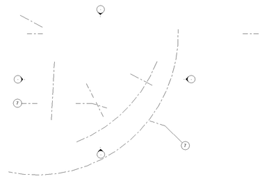

Here, in this example template, I can restore grid points '1' to '6', but not point '7' or '8' of the gridline "2". Ths same is true for grid"3", "4", "7"
The initial condition:
The result. The leader line for grid "4" looks different from the template, but there is yet no API to adjust it.
