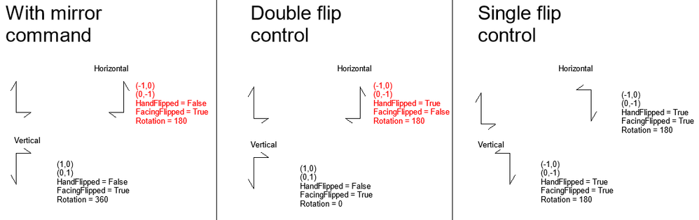

I found results that indicate Revit uses a combination of reflection and rotation for the various operations.
One thing that stands out is the difference between horizontal double flip control and mirror command about same axis (noted red). These operations are almost identical apart from the horizontal one that results in opposite facing and handed state. Graphically it appears the same but not according to facing/handed orientation.
It has been noted previously that single flip control is more like rotating rather than mirroring (it doesn't result in reflected geometry). We see by transform that it is reflected but facing/handed state is also set to true.
Generally I think of the facing/handed state as being an internal to the family state i.e. the internal geometry may be reflected but the family itself isn't (unless it is by transform).
You probably need to look at flip state/rotation and transform to get a definitive idea of the situation. These controls long ago I believe were introduced for doors, which side they are hung and swing direction. As they started being used for other things the ambiguities crept in i.e. double negative (same ultimate representation but two definitions for it).

Resurrecting an old topic here, I think there is another subtle thing happening with GetTransform(). I noticed that Revit actually creates a new GeometryElement when you mirror a family. Since there are only two configurations, original and mirrored, all other instances will reference either the original geometry element or the mirrored one. When you first mirror an element, I think Revit mirrors the original geometry along the horizontal axis, then computes whatever transform is necessary to place it properly. This is why if you mirror an element across a horizontal axis, GetTransform() shows IsTranslation as True; otherwise it shows False.
Note two different GeometryElements (6357 has the same original geometry as 6385, but 6367 has the same original geometry as 6391):
The bottom-left family has been mirrored across the horizontal axis, and shows as a translation (6357 shows as a translation, but 6367 has been mirrored across the vertical axis and is not):
