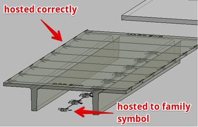

Hi all,
I am working on some code that will get the top face of a family I have loaded into the model to use as a host for NewFamilyInstance. I am trying to use both the Reference and Face overloads for it but just cannot seem to get it to work the way it should.
If I use the basic most simple way of getting the face, I am pulling it from the instance geometry, but then it hosts to the family symbol of the host family rather than to the family instance of the host family

If I use a ReferenceIntersector to get the face reference and pass that through, it inserts the family the correct way hosted to the family instance face.

I would much rather use the simpler code to easily get the face for the instance, but just cannot figure out why it wants to host to the family symbol rather than the family instance. Any ideas on what I would need to tweak here to get it to host correctly?

Wow you are an absolute legend! That was the missing piece to my puzzle! It's hosting exactly as it should now. Thank you for solving my headache for the last 2 weeks!
To archive the solution (Note you will likely want to change the conditions for finding the top face to use the normal as stated above, the logic here just works for the specific family I am using):

Happy you got this to work, but explicitly constructing the stableRep string definitely does NOT feel like the best approach to me... You mentioned that you compared the "GetInstanceGeom" vs "GetSymbolGeom". I am replying specifically to address this - you've stumbled upon a very tricky "gotchya" (one of many) in Revit's API. It had me stumped for a while in a different application. Reading the docs (specifically the last sentence in the REMARKS) in [0], and the explanations in [1] and [2] should help your understanding.
To summarize, (to the best of my understanding) the GetInstanceGeometry actually calls GetSymbolGeometry, makes a copy (which is now independent of the original object), and returns the results with the FamilyInstance.Transform applied. Therefore, the object ACTUALLY referenced by the resulting GeometryObjects is the FamilySymbol - and subsequently are not meaningful for creating new objects.
However, for your application, you SHOULD use "GetSymbolGeometry" because it is a reference to the "real GeometryObjects", and not independent/abstracted copies. Switching to this should work as you intend (and prevent you from having to explicitly construct stableReps - lol):
- You can verify this by:
[A]: setting ComputeReferences=true in your Options (as you already have)
[B]: querying the results from both "GetInstanceGeom" and "GetSymbolGeom", converting them to Solids, and concatenating all of the faces (as you already have)
[C]: from the results of faces in both collections, select face.Reference.CreateStableRepresentation(element.Document)
The (2) resulting List<string> created in [C] will show you that from GetInstanceGeometry, the referenced UniqueId actually belongs to the FamilySymbol, while the results from GetSymbolGeometry include both the UniqueId from FamilySymbol, but also an extra component that shows the UniqueId from the FamilyInstance (along with the word INSTANCE and some other info).
Overall, the intent of the API is clever - a sort of lazy-loading in the vein of the DRY principle... only the naming of the methods is IMHO backwards and therefore unintuitive.
Try out simply using the face obtained by GetSymbolGeometry and let us know how it works!

Thanks Ryan, you are spot on with this. I agree this naming convention is totally backwards from what you would expect so I didn't even think of trying that initially. That simplified the method quite a bit! Even so, I think the info provided by @TripleM-Dev.net will prove valuable to some other use cases in this project I am working on as it appears I can use that to access the special references 0-9.
